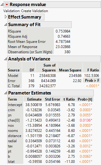

1. Select Analyze > Fit Model.
2. Select mvalue and click Y.
3. Select crim through lstat and click Add.
4. Select Create Validation and click Validation.
5. Select Stepwise in the Personality list.
6. Click the Run button.
7. Select P-value Threshold from the Stopping Rule list.
8. Click the Go button.
9. Click the Run Model button.
Figure 11.2 Fit Model Report
Fit Model Report
10. To save the prediction formula to a column, click the Response red triangle and select Save Columns > Prediction Formula.

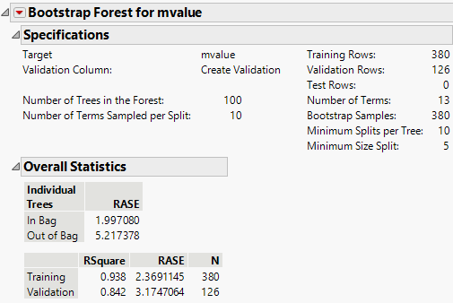

1. Select Analyze > Predictive Modeling > Bootstrap Forest.
2. Select mvalue and click Y, Response.
3. Select crim through lstat and click X, Factor.
5. Click OK.
6. Select the Early Stopping check box.
7. Select the Multiple Fits over number of terms check box.
8. Enter 617 in the box next to Random Seed.
9. Click OK.
Figure 11.3 Bootstrap Forest Model
10. To save the prediction formula to a column, click the Bootstrap Forest red triangle and select Save Columns > Save Prediction Formula.

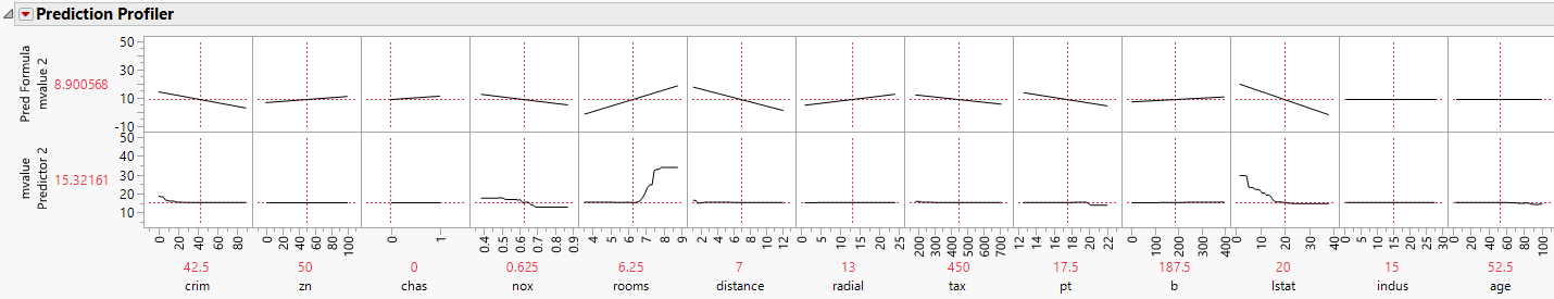

5. Click the Model Comparison red triangle and select Profiler.
Figure 11.5 Prediction Profiler for All Models
The prediction profiler enables you to compare the impact of each factor in the different models. The profiler is especially interesting when comparing different types of models such as here where you have a regression model and a partition model.
