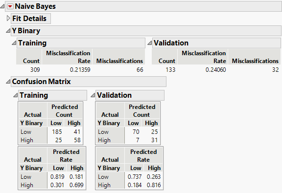

Figure 8.2 Naive Bayes Report
Naive Bayes Report
The Training Set has about a 21% misclassification rate and the Validation Set has about a 24% misclassification rate. The Confusion matrix suggests that, for both the Training and Validation sets, the larger source of misclassification comes from classifying patients with Low disease progression as having High disease progression. The Validation set results indicate how your model extends to independent observations.

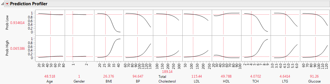

7. Click the Naive Bayes red triangle and select Profiler.
Figure 8.3 Prediction Profiler for Disease Progression

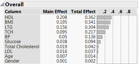

8. Click the Prediction Profiler red triangle and select Assess Variable Importance > Independent Uniform Inputs.
Figure 8.4 Variable Importance
Variable Importance
The Summary Report indicates that HDL, BMI, and LTG have the greatest impact on the estimated probabilities.
