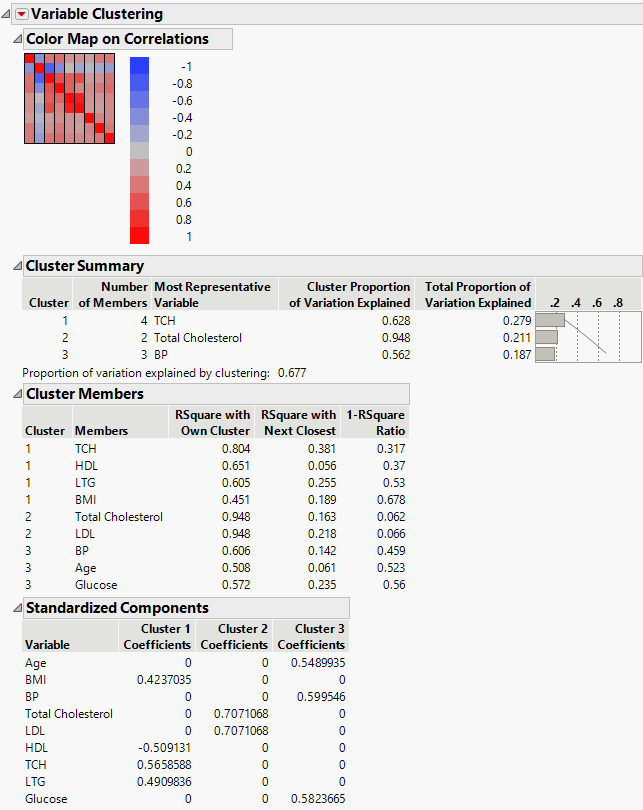

Figure 16.2 Cluster Variables Report for Diabetes Data
The Cluster Summary report shows that the variables were grouped into three clusters:
• Cluster 1 consists of TCH, HDL, LTG, and BMI, as shown in the Cluster Members report. The Cluster Summary report shows that TCH is the most representative variable for Cluster 1 and that for the variables in Cluster 1, 62.8% of the variation is explained by the first principal component.
• Cluster 2 consists of Total Cholesterol and LDL. The Cluster summary report shows that Total Cholesterol is the most representative variable for Cluster 2 and that for the variables in Cluster 2, 94.8% of the variation is explained by the first principal component.
• Cluster 3 consists of BP, Age, and Glucose. The Cluster Summary report shows that the most representative variable is BP and that for the variables in Cluster 3, 56.2% of the variation is explained by the first principal component.
