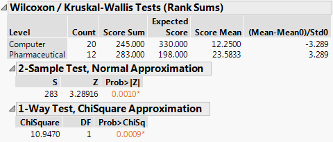

9. Click the red triangle next to Oneway Analysis of Profits ($M) By Type and select Nonparametric > Wilcoxon Test.
Figure 6.27 Wilcoxon Test Results
The Wilcoxon test is a nonparametric test. It is based on ranks, so it is resistant to outliers. Also, it does not require normality.
Both the normal and the chi-square approximations for the Wilcoxon test statistic indicate significance at a p-value of 0.0010. You conclude that there is a significant difference in the location of the distributions, and conclude that mean profit differs based on company type.
