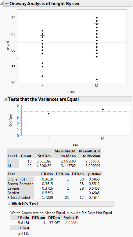

In this example, suppose you want to test whether two groups (males and females) have equal variance.
1. Select Help > Sample Data Library and open Big Class.jmp.
3. Select height and click Y, Response.
4. Select sex and click X, Factor.
5. Click OK.
6. Click the red triangle next to Oneway Analysis of height By sex and select Unequal Variances.
Figure 6.29 Example of the Unequal Variances ReportĀ
Since the p-value from the 2-sided F Test is large, you cannot conclude that the variances are unequal.
