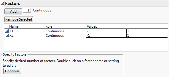

The initial Factors panel for a response surface design appears with two continuous factors.
Figure 11.14 Factors Outline
Factors Outline
The factors outline contains the following buttons.
Add
Enters the number of continuous factors specified.
Remove Selected
Removes the selected factors.

The Factors outline contains the following columns:
Name
The name of the factor. When added, a factor is given a default name of X1, X2, and so on. To change this name, double-click it and enter the desired name.
Role
Specifies the Design Role of the factor as Continuous. The Design Role column property for the factor is saved to the data table. This property ensures that the factor type is modeled appropriately.
Values
The experimental settings for the factors. To insert Values, click the default values and enter the desired values.
