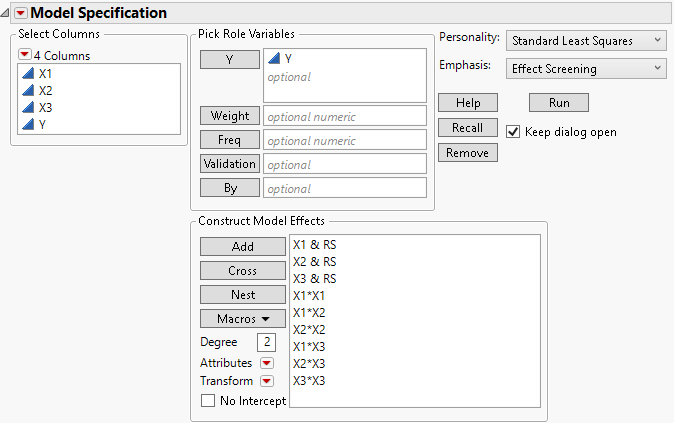

1. Select Help > Sample Data Library and open Design Experiment/Custom RSM.jmp.
Because the data table contains a Model script, the Model Specification window is filled out as specified in the Model script. Note the following:
– Main effects appear in the Construct Model Effects list with a &RS suffix, indicating that the Response Surface macro has been applied.
– The effects are those for a full response surface in the three predictors X1, X2, and X3.
– Because the model contains terms with the &RS suffix, the analysis results will include a Response Surface report.
Figure 4.9 Fit Model Launch Window for the Response Surface Analysis
