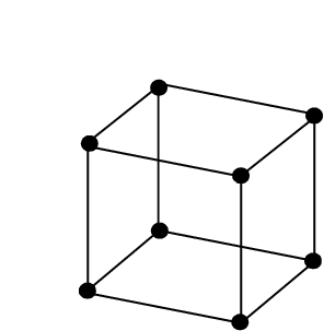

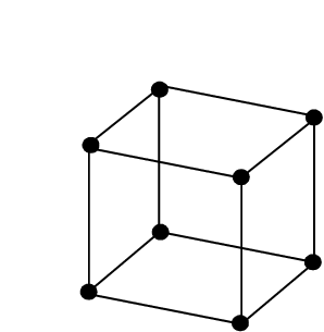

Figure 12.1 Full Factorial Design for Three Two-Level Factors
