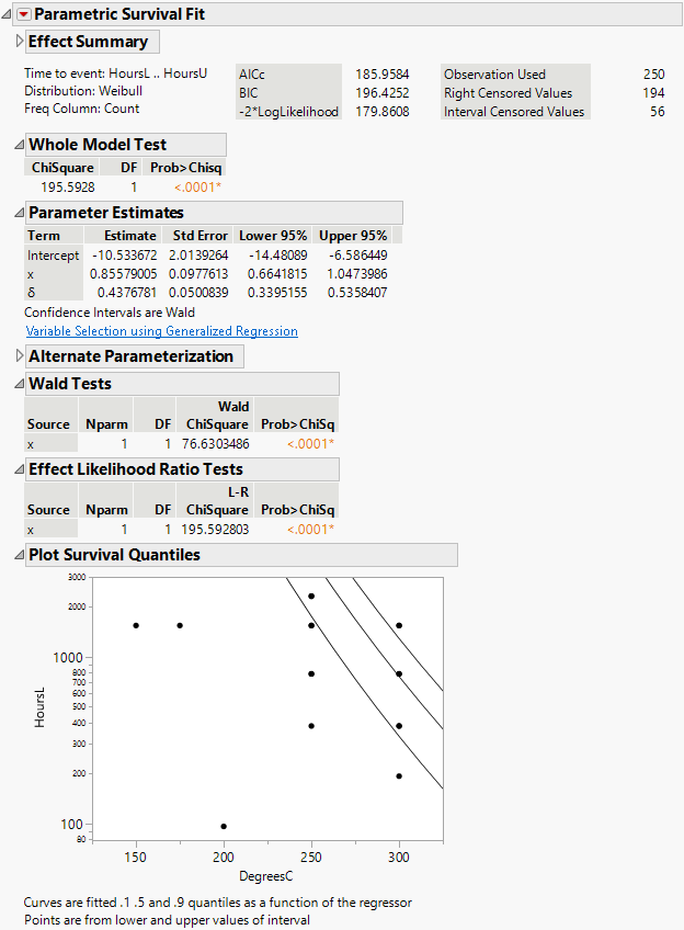

Figure 14.12 ICDevice OutputĀ
ICDevice Output
The resulting regression shows a plot of time by degrees.
