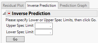

Use the Inverse Prediction tab to predict the time at which the Y variable reaches a specified value. These times are sometime called pseudo failure times.
Figure 7.13 Inverse Prediction Tab
Enter either the Lower or Upper Spec Limit. Generally, if your Y variable decreases over time, then enter a Lower Spec Limit. If the Y variable increases over time, then enter an Upper Spec Limit.

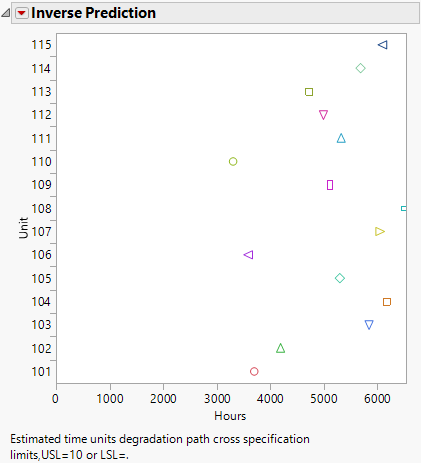

For the GaAs Laser example, enter 10 for the Upper Spec Limit and click Go. A plot is produced showing the estimated times until the units reach a 10% increase in operating current.
Figure 7.14 Inverse Prediction Plot
