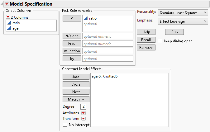

1. Select Help > Sample Data Library and open Growth.jmp.
3. Select the ratio column and click Y.
4. Select the age column and click Add.
5. Select age in the Effects pane and select Attributes > Knotted Spline Effect.
6. For the number of knots, type 5 and click OK.
Figure 4.21 Fit Model Launch Window
7. Click Run.

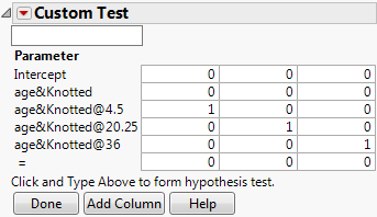

8. Click the Response ratio red triangle and select Estimates > Custom Test.
In the Custom Test report, notice that there is only one column. You want three columns.
9. Click the Add Column button twice to produce a total of three columns.
10. In the first column, type 1 for age&Knotted@4.5.
11. In the second column, type 1 for age&Knotted@20.25.
12. In the third column, type 1 for age&Knotted@36.
Figure 4.22 Values for the Custom Test for Curvature

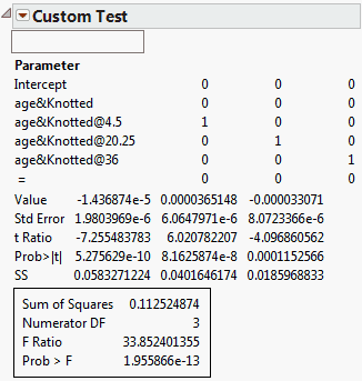

13. Click Done.
The small Prob > F value in the Custom Test report indicates that there is curvature.
Figure 4.23 Curvature Report
Curvature Report
