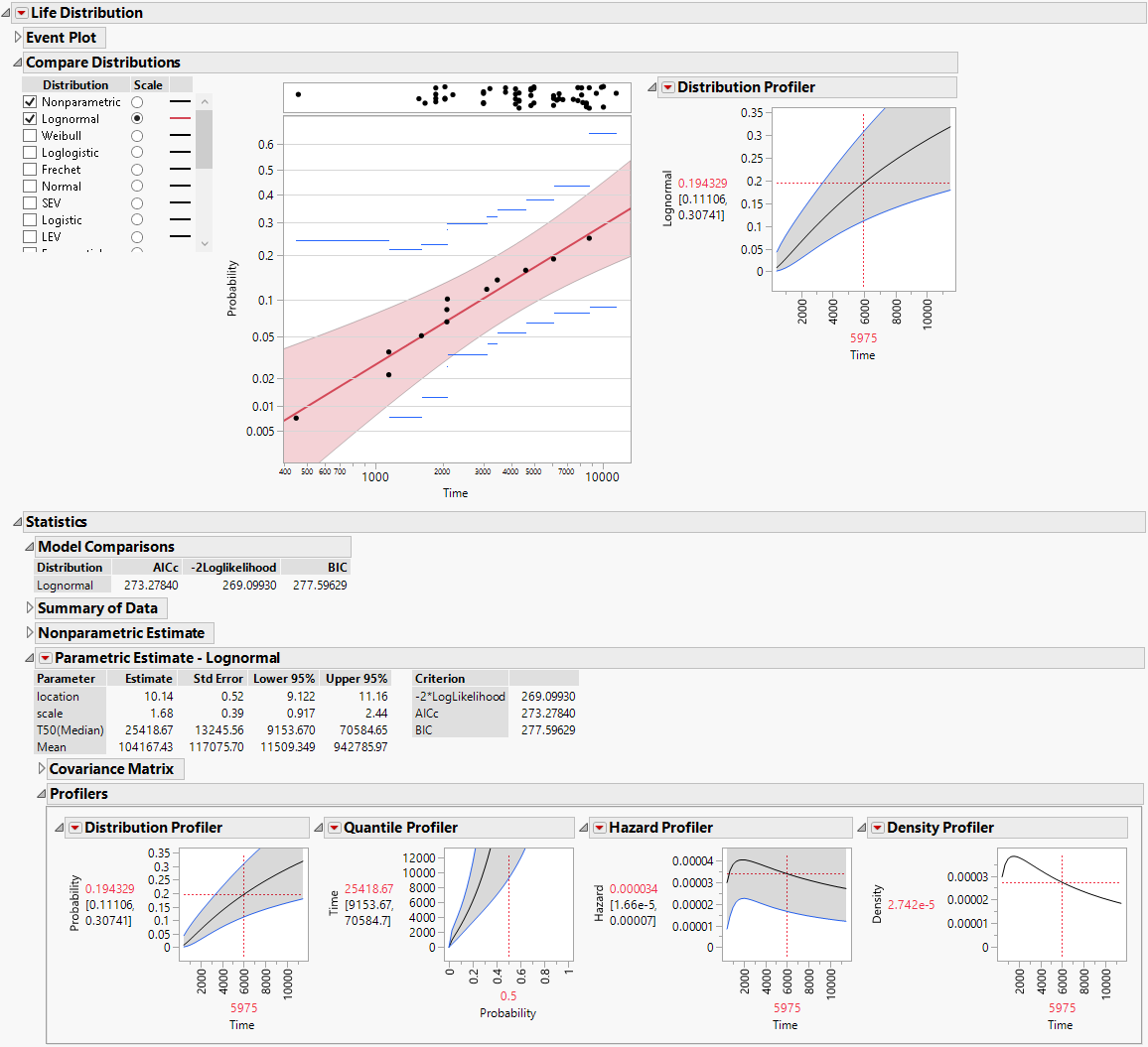

If you have not selected a Failure Cause in the launch window, the Life Distribution report appears. Use this report to analyze lifetime data where some time observations might be censored. The Life Distribution report contains the following content and options:
• Event Plot
• Compare Distributions
• Life Distribution: Statistics
• Life Distribution Report Options
Figure 3.6 Example of the Life Distribution Report for Fan.jmp
