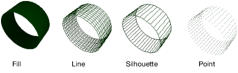

Quadric Draw Style(mode) specifies the drawing mode. The argument mode can be Fill, Line, Silhouette, or Point.

Figure 13.13 Draw Styles
Draw Styles
