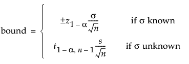

The bound is calculated as:

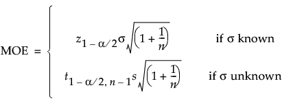

The margin of error (MOE) for prediction intervals is calculated as follows:

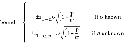

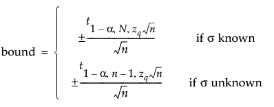

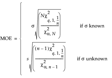

For the tolerance interval on a proportion q of the population, the margin of error or bound is computed based on approximate procedures described in Krishnamoorthy and Mathew (2009).
The margin of error (MOE) for tolerance intervals is calculated as follows:
where N is a suitably large integer value to represent asymptotic behavior. JMP sets the value of N to 2000.
