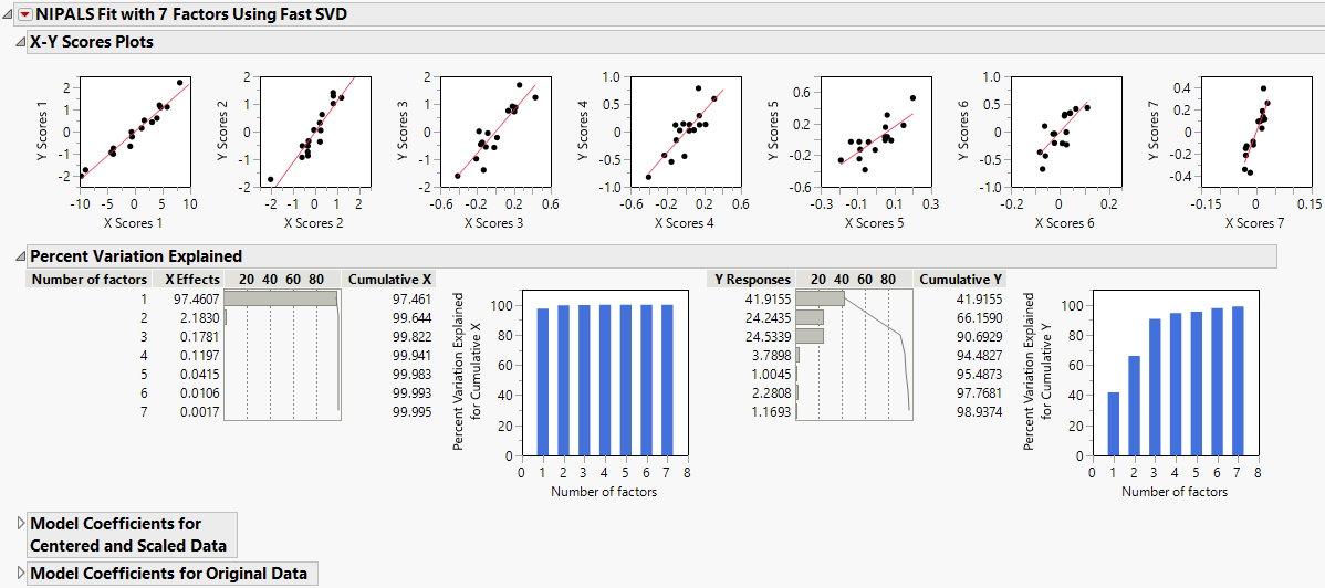

The Model Fit Report shows detailed results for each fitted model. The fit uses either the optimum number of factors based on cross validation, or the specified number of factors if no cross validation methods are specified. The report title indicates whether NIPALS or SIMPLS was used, whether Fast SVD or Classical SVD was used, and gives the number of extracted factors.
Figure 6.12 Model Fit ReportĀ
Model Fit Report
The Model Fit report includes the following summary information:
X-Y Scores Plots
Scatterplots of the X and Y scores for each extracted factor.
Percent Variation Explained
Shows the percent variation and cumulative percent variation explained for both X and Y. Results are given for each extracted factor.
Model Coefficients for Centered and Scaled Data
For each Y, shows the coefficients of the Xs for the model based on the centered and scaled data.
