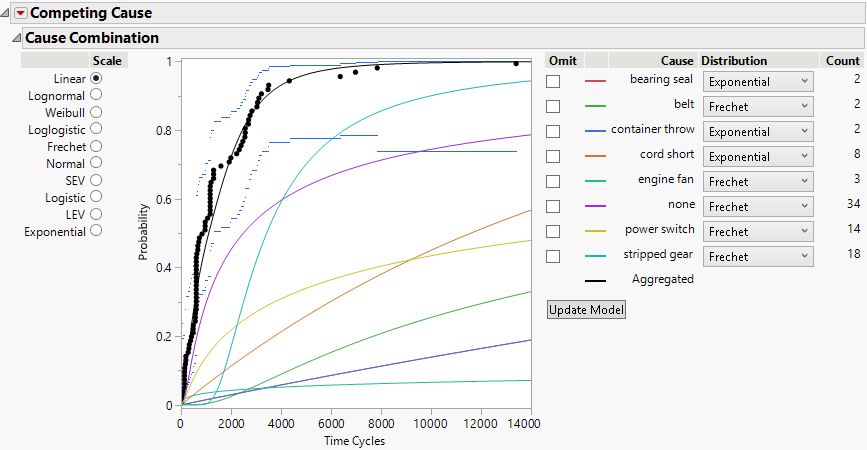

On the Competing Cause report, JMP shows the best distribution fit for each failure cause.
Figure 3.11 Initial Competing Cause Report

10. Select Omit for bearing seal, belt, container throw, cord short, and engine fan (the causes with the fewest failures).
The estimated time by which 10% of the failures occur is now 263.
Figure 3.13 Updated Failure Time
When power switch and stripped gear are the only causes of failure, the estimated time by which 10% of the failures occur increases by approximately 31%.
