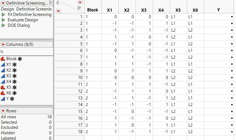

In the Definitive Screening Design table, the Table panel (in the upper left) contains the following scripts. To run a script, click the green triangle next to the script name.
Fit Definitive Screening
Runs the DOE > Definitive Screening > Fit Definitive Screening platform. See The Fit Definitive Screening Platform.
Evaluate Design
Runs the DOE > Design Diagnostics > Evaluate Design platform. See Evaluate Designs.
DOE Dialog
Re-creates the Definitive Screening Design window that you used to generate the design table.
Figure 7.20 Definitive Screening Design Table Showing Scripts
