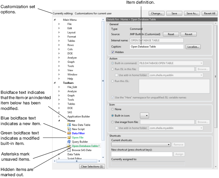

You personalize toolbars and menus in the Menu Editor. The names of modified items are formatted to indicate which items were created, modified, or hidden, and which items are unsaved.
Figure 12.1 Menu Editor OptionsĀ
Menu Editor Options
