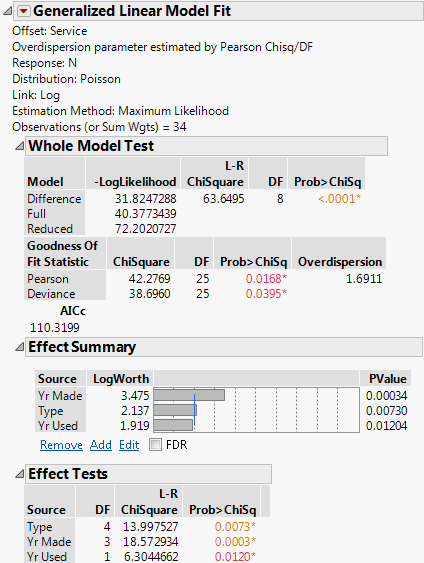

The sample data table Ship Damage.JMP is adapted from data found in McCullagh and Nelder (1989). The data table contains information about a certain type of damage caused by waves to the forward section of the hull. Hull construction engineers are interested in the risk of damage associated with three variables: ship type (Type), the year in which the ship was constructed (Yr Made), and the block of years the ship was in service (Yr Used).
In this analysis we use the variable Service, the log of the aggregate months of service, as an offset variable. An offset variable is one that is treated like a regression covariate whose parameter is fixed to be 1.0. Offset variables are most often used to scale the modeling of the mean in Poisson regression situations with a log link. In this example, we use log(months of service) since one would expect that the number of repairs be proportional to the number of months in service.

From the report, notice that all three effects (Type, Yr Made, Yr Used) are significant.
Figure 12.7 Partial Report for a Poisson with Offset Model
