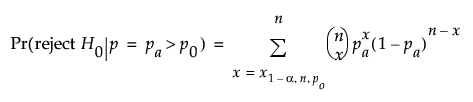

For one-sided, higher alternative:
Equation shown here

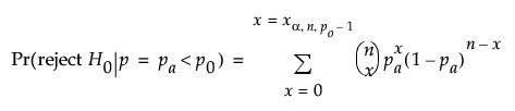

for a one-sided, lower alternative:
Equation shown here

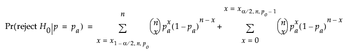

for a two-sided alternative:
Equation shown here
where xq,n,p is the qth quantile of a binomial distribution with n trials and probability p.

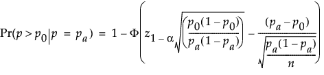

For a one-sided, higher alternative:
Equation shown here

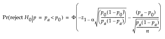

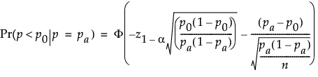

For a one-sided, lower alternative:
Equation shown here

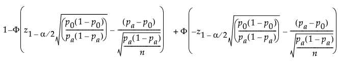

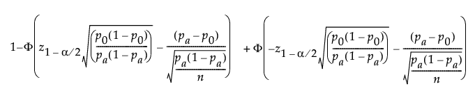

For a two-sided alternative:
Equation shown here
Equation shown here
