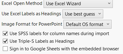

Figure 13.11 Third Party Data Preferences

Excel Open Method
Select one of the options to determine how JMP imports Microsoft Excel worksheets.
Excel Wizard
Lets you preview a Microsoft Excel worksheet and modify the settings before importing the data. This is the default setting on Windows. On macOS, all .xlsx files open in the Excel Wizard.
Open All Sheets
Opens all worksheets in the workbook. On macOS, this preference is only for .xls files.
Select Individual Worksheets
Lets you select the worksheets that you want to open from a workbook. On macOS, this preference is only for .xls files. The option is also provided on macOS when you open an Excel (.xls) file.
On Windows, you can also select File > Open, select the workbook, click the Open button arrow, and select Open Selected Worksheets or Use Excel Wizard.
Use Excel Labels as Headings
Select this option to allow JMP to use Excel label names as column headings when importing Excel files. Available settings include:
• Use best guess (default)
• Always
• Never
Image Format for PowerPoint
Select the default file format for images exported to Microsoft PowerPoint.
Windows does not support the native PDF graphics produced on macOS. macOS does not support the native EMF graphics produced on Windows. For cross-platform compatibility, specify the PNG or JPEG graphic format. Additional file formats are available through scripting. See db<<Save Presentation(<path>, <Template(path)>, <Insert("Begin"|"End"|n)|Replace("Begin"|"End"|n)|Append>, <Outline Titles(title location)>, <format>) in the JSL Syntax Reference.
Use SPSS Labels for column names during import
Select this option to allow JMP to use SPSS label names as column headings when importing SPSS files.
Use Triple-S Labels as Headings
Select this option to allow JMP to use Triple-S label names as column headings.
Sign in to Google Sheets with the embedded browser
Select this option to use the embedded JMP browser for signing in to Google Sheets instead of the default system browser.
