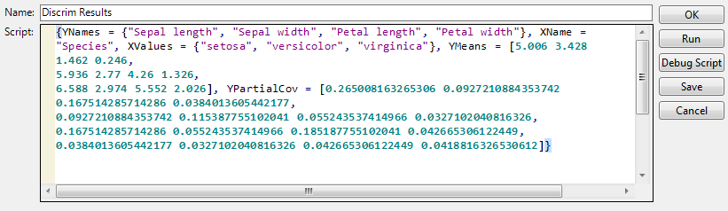

Save Discrim Matrices creates a global list (DiscrimResults) for use in the JMP scripting language. The list contains the following, calculated for the training set:
• YNames, a list of the covariates (Ys)
• XName, the categorical variable
• XValues, a list of the levels of X
• YMeans, a matrix of the means of the covariates by the levels of X
• YPartialCov, the within covariance matrix
Consider the analysis obtained using the Discriminant script in the Iris.jmp sample data table. If you select Save Discrim Matrices from the Discriminant Analysis red triangle menu, the script Discrim Results is saved to the data table.
Figure 5.16 Discrim Results Table Script for Iris.jmp
