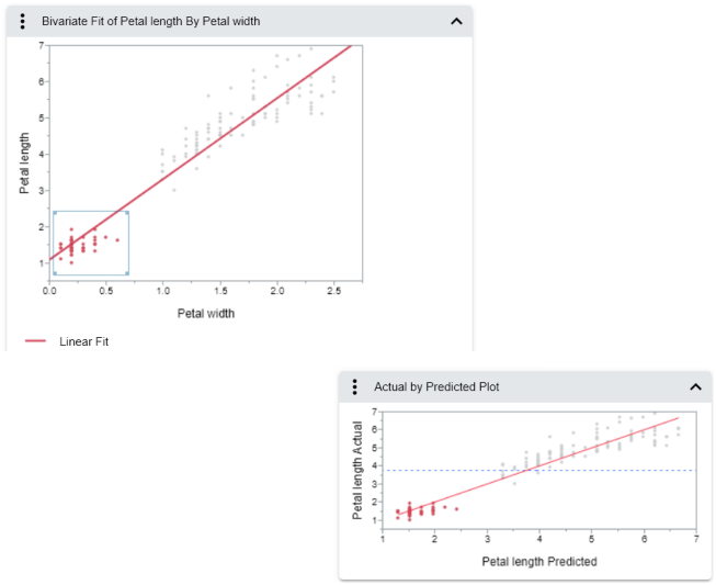

Figure 7.14 Brushing Data in Interactive HTML
