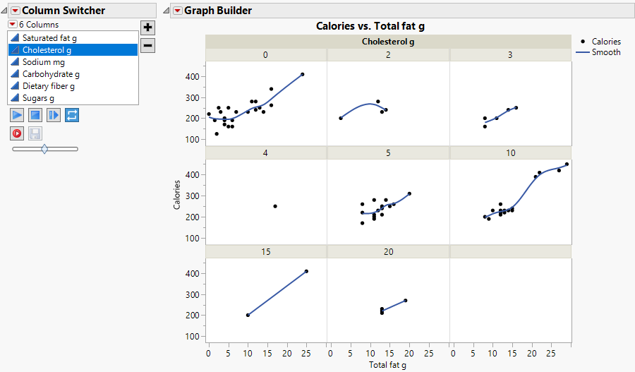

Example of the Column Switcher
You have data about nutrition information for candy bars. You want to examine different factors, to see which factors best predict calorie levels.
1. Select Help > Sample Data Library and open Candy Bars.jmp.
3. Click Total fat g and drag to the X zone.
4. Click Calories and drag to the Y zone.
5. Click Cholesterol g and drag to the Wrap zone.
6. Click the Graph Builder red triangle and select Show Control Panel.
7. Click the Graph Builder red triangle and select Redo > Column Switcher.
8. Select Cholesterol g.
This chooses the initial column to switch.
9. Select Saturated fat g, Cholesterol g, Sodium mg, Carbohydrate g, Dietary fiber g, and Sugars g.
This chooses the replacement columns.
10. Click OK.
Figure 9.6 Column Switcher in Graph Builder Window
11. Click the Play button to cycle between the different factors. Use the slider to control the speed of the animation. Alternatively, you can step through each factor individually.
Click the Looping button to specify the behavior of the animation when it reaches the last column in the Columns list.
You can see that the relationship between calories and fat is relatively strong for each level of carbohydrate. Therefore, Carbohydrate g appears to be the best predictor of calorie levels.
