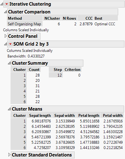

Self Organizing Map Report
Figure 13.9 Self Organizing Map ReportĀ
The Cluster Comparison Report shows the total number of clusters and also the number of rows requested. The SOM report is named according to the Grid size requested. The Bandwidth is given at the top of the SOM Grid report. The report itself is analogous to the K Means NCluster report. See K Means Report.
