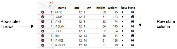

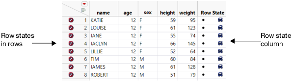

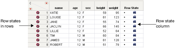

Figure 5.4 Row States in Rows and a Row State Column
