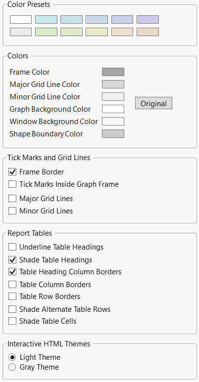

Figure 13.5 Styles Preferences
Styles Preferences

Color Presets
The Color Presets provides a set of predefined colors for use in customizing the appearance of reports, graphs, charts, and so on Tints of the selected color are applied to the various elements.
Note: The selected color is applied also to windows.
Frame Color
Defines the color applied to a graph frame and tick marks. Click to change the default color.
Major Grid Line Color
Defines the major grid line color. Click to change the default color.
Minor Grid Line Color
Defines the minor grid line color. Click to change the default color.
Graph Background Color
Click the color box to select a background color for all graphs. Click to change the default color.
Window Background Color
Click the color box to select a background color for all reports and data tables. Click to change the default color.
Shape Boundary Color
Click the color box to select the color for shape files boundaries.
Original
Click to restore default color settings.
Frame Border
Shows borders only on the axes. This option is selected by default.
Tick Marks Inside Graph Frame
Shows axis tick marks inside the graph frame. This option is deselected by default.
Major Grid Lines
Shows major grid lines on graphs. This option is deselected by default.
Minor Grid Lines
Shows minor grid lines on graphs. This option is deselected by default.
Underline Table Headings
Shows border under table headings. This option is deselected by default.
Shade Table Headings
Shows table headings with shading. This option is selected by default.
Table Heading Column Borders
Shows divider lines between columns in table headings. This option is selected by default.
Table Column Borders
Shows borders between table columns. This option is deselected by default.
Table Row Borders
Shows borders between table rows. This option is deselected by default.
Shade Alternate Table Rows
Shows alternate table rows with shading. This option is deselected by default.
Shade Table Cells
Shows table cells with shading. This option is deselected by default.
Interactive HTML Themes
Specifies the color theme for interactive HTML pages. The default theme is Light Theme.
