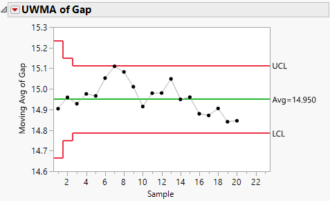

Figure 12.21 UWMA Charts for the Clips1 data
The point for the first day is the mean of the five subgroup sample values for that day. The plotted point for the second day is the average of subgroup sample means for the first and second days. The points for the remaining days are the average of subsample means for each day and the two previous days.
The average clip gap appears to be decreasing, but no sample point falls outside the 3σ limits.
