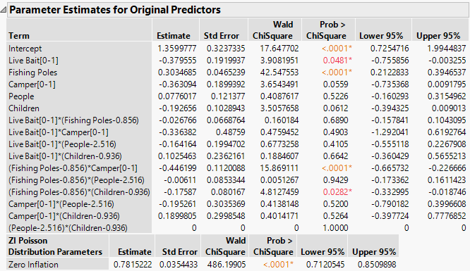

The Generalized Regression report that appears contains a Model Comparison report, a Model Launch control panel, and a ZI Poisson Maximum Likelihood with Validation Column report. Note that the default estimation method is the Lasso.
9. From the Estimation Method List, select Elastic Net.
10. Click Go.
A ZI Poisson Elastic Net with Validation Column report appears. The Solution Path, the Parameter Estimates for Original Predictors report, and the Effect Tests report indicate that one term is zeroed. The Zero Inflation parameter, whose estimate is shown on the last line of both Parameter Estimates reports, is highly significant. This indicates that some of the variation in the response, Fish Caught, might be due to the fact that some groups did not fish.
Figure 7.6 Parameter Estimates for Original Predictors Report
The Effect Tests report indicates that four terms are significant at the 0.05 level: Live Bait, Fishing Poles, Fishing Poles*Camper, and Fishing Poles*Children.

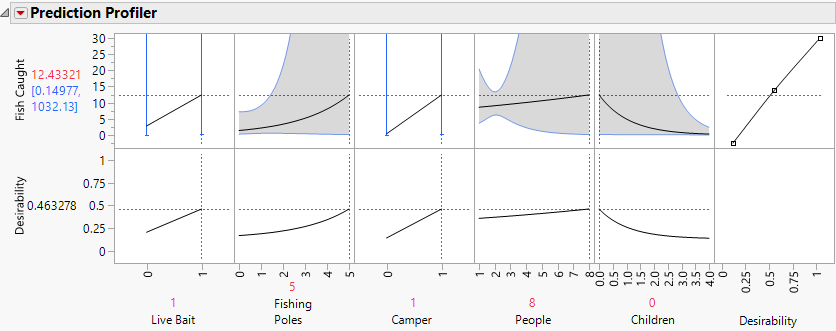

11. Click the red triangle next to ZI Poisson Elastic Net with Validation Column and select Profilers > Profiler.
12. Click the Prediction Profiler red triangle and select Optimization and Desirability > Desirability Functions.
A function is imposed on the response, which indicates that maximizing the number of Fish Caught is desirable. For more information about desirability functions, see Desirability Profiling and Optimization in Profilers.
13. Click the Prediction Profiler red triangle and select Optimization and Desirability > Maximize Desirability.
Figure 7.7 Prediction Profiler with Fish Caught Maximized
You can vary the settings of the predictors to see the impact of the significant effects: Live Bait, Fishing Poles, Fishing Poles*Camper, and Fishing Poles*Children. For example, Live Bait is associated with more fish; a Camper tends to bring more fishing poles than someone who is not camping and therefore catches more fish.
