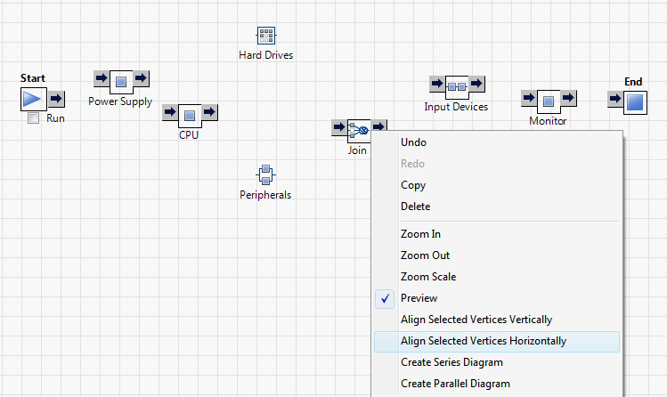

Image shown hereAlign Shapes
1. To vertically align the shapes for Hard Drives and Peripherals, select the components:
– Hard Drives
– Peripherals
Tip: To select shapes, drag the cursor around the shapes or press Shift and click each shape.
2. With the shapes selected, right-click one of the shapes and select Align Selected Vertices Vertically.
3. To horizontally align the remaining shapes, select the following components:
– Start
– Power Supply
– CPU
– Join
– Input Devices
– Monitor
– End
4. With the shapes selected, right-click one of the shapes and select Align Selected Vertices Horizontally.
Figure 11.8 Align Shapes Horizontally
5. Proceed with Connect Shapes.
