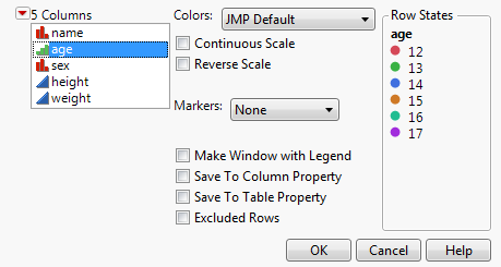

To assign colors or markers to rows based on column values
1. Select Rows > Color or Mark by Column.
2. Select the column to color and or mark.
Figure 4.29 Color or Mark by Column
3. Select the Colors and Markers schemes to apply.
A preview of your selection appears under Row States.
4. (Optional) Select any additional options. See Color or Mark by Column Options.
5. Click OK.
6. (Optional) To shade all rows according to their row state, right-click in the row numbers area within the data grid and select Color Rows by Row State.
From then on, the rows are shaded with the color that you assign to the rows.
Colors
Select a color theme to assign different colors to the rows in your data table. Color assignment is based on the values of the selected column.
Continuous Scale
Assigns colors in a chromatic sequence based on the values in the highlighted column.
Reverse Scale
Assigns colors in a reversed chromatic sequence based on the values in the highlighted column.
Markers
Assigns a different marker to each row in your data table based on the values found in the column that you highlighted.
Make Window with Legend
Includes a legend with your new characteristics so that you can easily identify which colors and markers correspond with which row.
Save To Column Property
Saves the color and marker information as a column property. The rows in the selected column of the data table are colored, based on the color theme.
Save To Table Property
Saves the color and marker information as a table property.
Excluded Rows
Assigns colors or markers to rows that are excluded.
