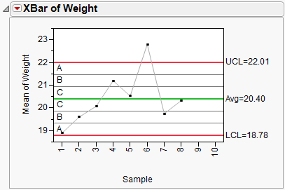

Show Zones
Shows or hides the zone lines. The zones are labeled A, B, and C as shown here in the Mean plot for weight in the Coating.jmp sample data. Control Chart tests use the zone lines as boundaries. The seven zone lines are set one sigma apart, centered on the center line.
Figure 12.14 Show Zones

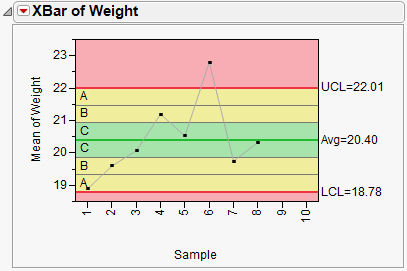

Shade Zones
Shows or hides the default green, yellow, and red colors for the three zone areas and the area outside the zones. Green represents the area one sigma from the center line, yellow represents the area two and three sigmas from the center line, and red represents the area beyond three sigmas. Shades can be shown with or without the zone lines.
Tip: To change the colors used to shade the zones, right-click in the control chart and select Customize. In the Customize Graph window, you can specify colors for each of the three zones.
Figure 12.15 Shade Zones
