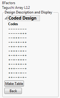

Display Coded Design
After you select a Taguchi design type for the inner and outer arrays, the Coded Design appears when your inner array has two-level factors.
Figure 14.11 Coding for Eight Factor L12 Design
The Coded Design shows the pattern of high and low values for the factors in each run.
