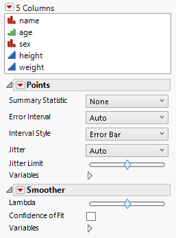

For each element that you add to a graph, an outline appears in the Properties area at left. This is where you specify and change properties for each element type.
Figure 3.23 Properties Areas for Points and Smoother

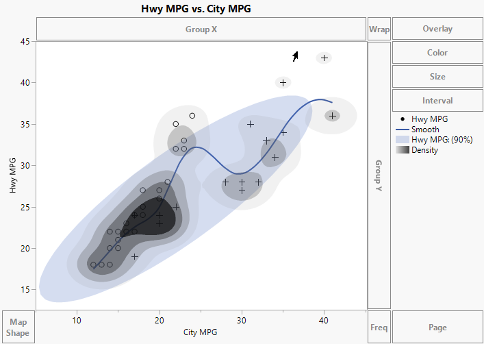

Figure 3.24 Graph Showing Points, Smoother, Ellipse, and Contour Elements
