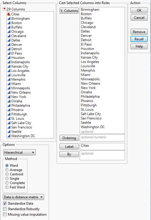

1. Select Help > Sample Data Library and open Flight Distances.jmp.
2. Select Analyze > Clustering > Hierarchical Cluster.
3. In the list at the bottom left corner of the launch window, change Data as usual to Data is distance matrix.
4. Select Cities and click Label.
5. Select all remaining columns and click Y, Columns.
Figure 12.6 Completed Distance Matrix Launch Window
6. Click OK.

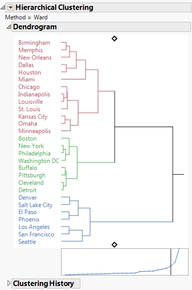

7. Click the Hierarchical Clustering red triangle and select Color Clusters.
Figure 12.7 Dendrogram Report for Flight Distances
In the Dendrogram report for the flight distances, the placement of the diamonds indicates that the model has grouped the cities into three clusters. The clusters are color-coded on the dendrogram. For more information about how to interpret the report, see Dendrogram Report.
