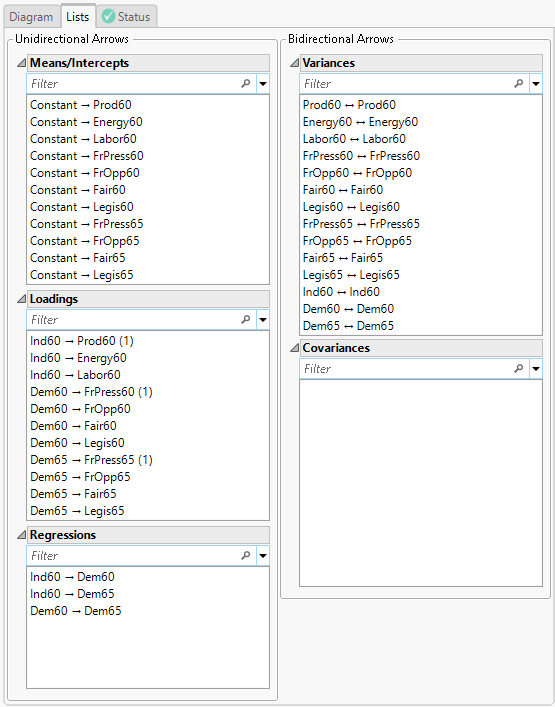

9. Select Ind60 in the From List, select Dem60 in the To List, and click the unidirectional arrow
button.
10. Select Ind60 in the From List, select Dem65 in the To List, and click the unidirectional arrow
button.
11. Select Dem60 in the From List, select Dem65 in the To List, and click the unidirectional arrow
button.
Figure 8.6 Loadings and Regressions

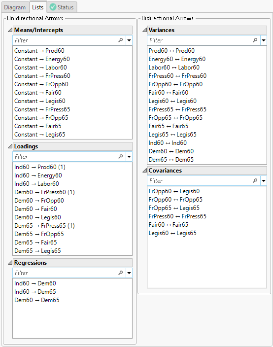

12. Select FrOpp60 in the From List, select Legis60 and FrOpp65 in the To List, and click the bidirectional arrow
button.
13. Select FrOpp65 in the From List, select Legis65 in the To List, and click the bidirectional arrow
button.
14. Select FrPress60 in the From List, select FrPress65 in the To List, and click the bidirectional arrow
button.
15. Select Fair60 in the From List, select Fair65 in the To List, and click the bidirectional arrow
button.
16. Select Legis60 in the From List, select Legis65 in the To List, and click the bidirectional arrow
button.
Figure 8.7 Covariances

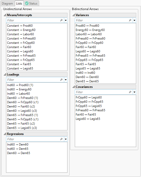

17. Select Dem60->FrOpp60 and Dem65->FrOpp65 in the Loadings list and click Set Equal.
18. Select Dem60->Fair60 and Dem65->Fair65 in the Loadings list and click Set Equal.
19. Select Dem60->Legis60 and Dem65->Legis65 in the Loadings list and click Set Equal.
Figure 8.8 Completed Model Specification
The constraints on the loadings are designated by alphanumeric labels. For example, you can see that Dem60->FrOpp60 and Dem65->FrOpp65 are set equal because they both are labeled “c1”.

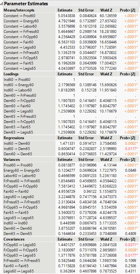

Figure 8.10 Structural Equation Model Parameter Estimates Report
Next, the parameter estimates under Regressions suggest positive effects of Ind60 on Dem60 and Dem65, as well as a positive effect of Dem60 on Dem65. Thus, higher scores on Ind60 are associated with higher Dem60 and Dem65, and higher scores in Dem60 are associated with higher scores in Dem65. The corresponding p-values for the parameter estimates are shown under Regressions. All 3 regression parameters are significant at the α = 0.05 level. Therefore, you conclude that there are nonzero relationships between the latent variables.
