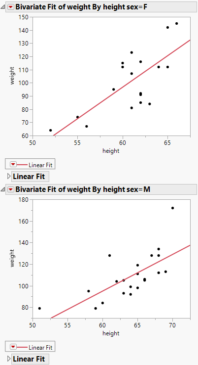

7. Press Ctrl, click the red triangle menu next to Bivariate Fit of weight By height sex =F, and select Fit Line from the red triangle menu.
Figure 5.25 Example of By Variable PlotsĀ
There are separate analyses for each level of the By variable (sex). So you see a scatterplot for the females and a scatterplot for the males.
