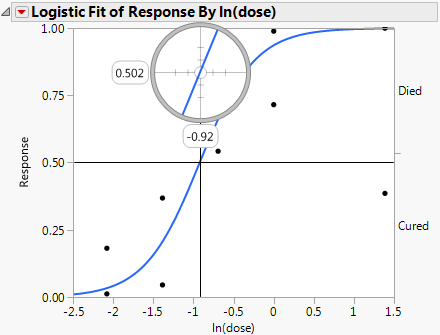

7. Click the crosshairs tool.
8. Place the horizontal crosshair line at about 0.5 on the vertical (Response) probability axis.
9. Move the cross-hair intersection to the prediction line, and read the In(dose) value that shows on the horizontal axis.
In this example, a rabbit with a ln(dose)of approximately -0.9 is equally likely to be cured as it is to die.
Figure 8.10 Example of Crosshair Tool on Logistic PlotĀ
