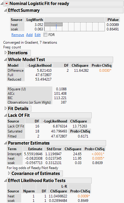

Figure 11.2 Nominal Logistic Fit ReportĀ
In the Whole Model Test report, the chi-square statistic (11.64) has a small p-value (0.0030), which indicates that the overall model is significant. However, the parameter estimate for soak has a p-value of 0.8639, which indicates that soaking time is not statistically significant.

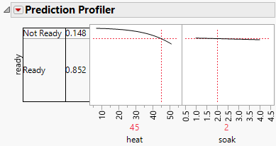

Figure 11.3 Prediction ProfilerĀ
Prediction Profiler
When heat is set at 45 and soak is set at 2 the probability of ready is 0.85.
