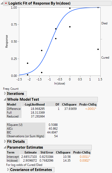

Use the Logistic platform to examine the relationship between a nominal Y response and a continuous X factor. The data in this example come from an experiment where 5 groups, each containing 12 rabbits, were injected with streptococcus bacteria. Once the rabbits were confirmed to have the bacteria in their system, they were given different doses of penicillin. You want to find out whether the natural log of dosage amounts has any effect on whether the rabbits are cured.
1. Select Help > Sample Data Folder and open Penicillin.jmp.
3. Select Response and click Y, Response.
4. Select ln(dose) and click X, Factor.
Notice that JMP automatically fills in Count for Freq. Count was previously assigned the role of Freq.
5. From the Target Level list, select Cured.
6. Click OK.
Figure 8.2 Example of Nominal Logistic ReportĀ
The plot shows the fitted model as a function of ln(dose). The fitted model is the predicted probability of being cured. The p-value is significant, indicating that the dosage amounts have a significant effect on whether the rabbits are cured.
