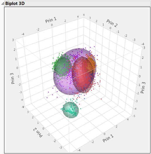

7. Click the red triangle next to Normal Mixtures NCluster=6 and select Biplot 3D.
Note: Your biplot 3D might appear differently because the algorithm has a random starting value.
Figure 14.3 3D Biplot of Cytometry Data
The plot shows contours for the normal densities that are fit to the clusters. Note that one cluster appears to be distinctly separated from the other clusters based on the first three principal components.
