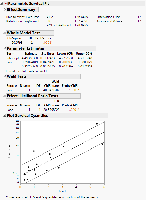

Figure 14.2 Computing Time Output
When there is only one effect, a plot of the survival quantiles for three survival probabilities are shown as a function of the effect.
