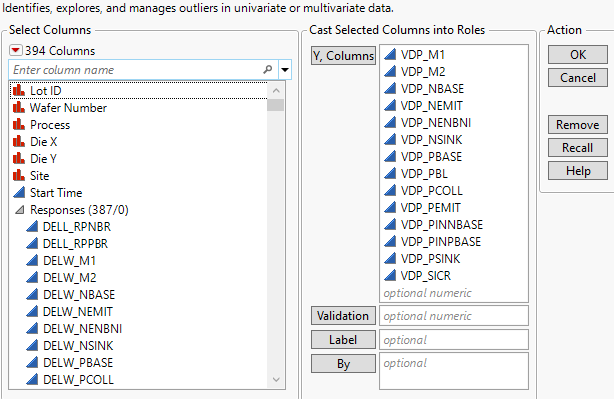

Example of the Explore Outliers Utility
Use the Explore Outliers utility to identify outliers within a select group of columns of a data set. The identified outliers can then be examined using the Distribution platform.
1. Select Help > Sample Data Folder and open the Probe.jmp sample data table.
2. Select Analyze > Screening > Explore Outliers.
3. Click the triangle next to Responses(387/0) to show all of the columns in the group.
4. Select columns VDP_M1 through VDP_SICR and click Y, Columns. There should be 14 columns selected.
Figure 21.2 Explore Outliers Launch Window

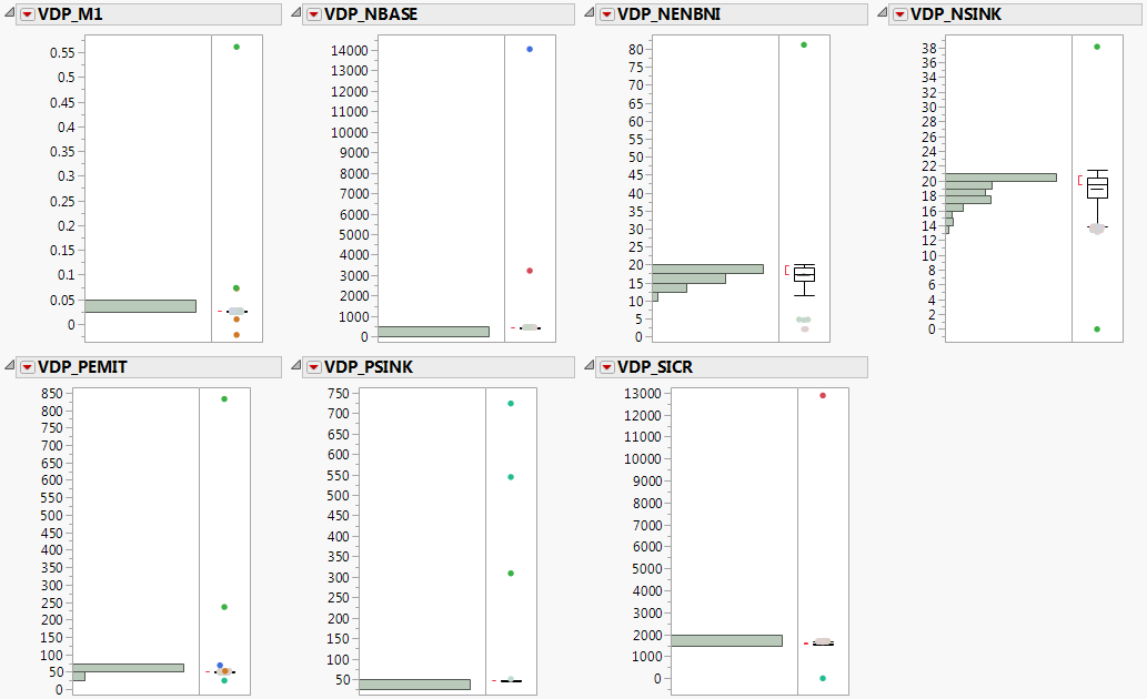

Examine the Data
1. Select all of the remaining columns in the Quantile Range Outliers report.
2. Click Select Rows.
3. Select Analyze > Distribution.
4. Assign the selected columns to the Y, Columns role. Because you selected these column names in the Quantile Range Outliers report, they are already selected in the Distribution launch window.
5. Click OK.
Figure 21.3 Distribution of Columns with Outliers Selected
In columns VDP_M1 and VDP_PEMIT, notice that some of the selected outliers are somewhat close to the majority of data. For the rest of the columns, the selected outliers appear distant from the majority of data. Investigate the data points and exclude them from your analyses.

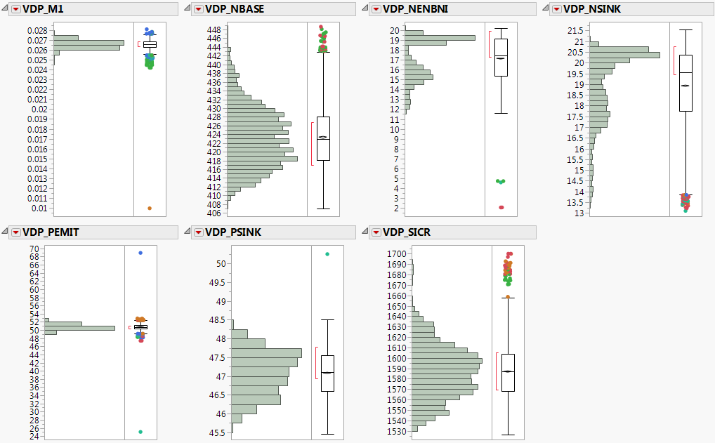

Refine Excluded Outliers
1. In the Quantile Range Outliers report, hold Ctrl and deselect columns VDP_M1 and VDP_PEMIT.
2. With the remaining columns selected in the report, click Exclude Rows.
3. Change Q to 20.
4. Click Rescan.
5. Select columns VDP_M1 and VDP_PEMIT in the report.
6. Click Select Rows.
Reexamine the Data
1. Examine the Distributions report again. Notice the selected outliers are now separate enough from the majority of the data to select and exclude them from your analyses.
2. In the Quantile Range Outliers report, click Exclude Rows.
3. In the Distributions report, click the Distributions red triangle and select Redo > Redo Analysis.
Figure 21.4 Distributions of Columns with Outliers Excluded
The displays of the distributions of the data are now more informative without the outliers.
