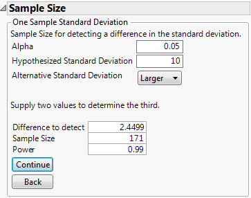

1. Select DOE > Design Diagnostics > Sample Size and Power.
2. Click One Sample Standard Deviation.
3. Leave Alpha as 0.05.
4. Enter 10 for Hypothesized Standard Deviation.
5. Select Larger for Alternative Standard Deviation.
6. Enter 2.4499 for Difference to Detect.
7. Leave Sample Size blank.
8. Enter 0.99 for Power.
9. Click Continue.
Figure 17.11 One-Sample Standard Deviation Calculator
You must test 171 wafers in order to have a 99% chance of detecting an increase in the standard deviation of 2.4499 from a standard deviation of 10, with an alpha of 0.05.
