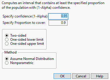

Figure 3.19 The Tolerance Intervals Window
6. Keep the default selections, and click OK.

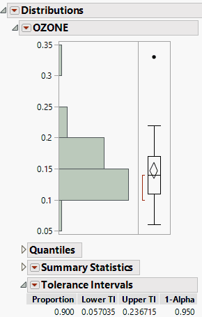

Figure 3.20 Example of a Tolerance Interval Report
In this example, you can be 95% confident that at least 90% of the population lie between 0.057035 and 0.236715, based on the Lower TI (tolerance interval) and Upper TI values.
