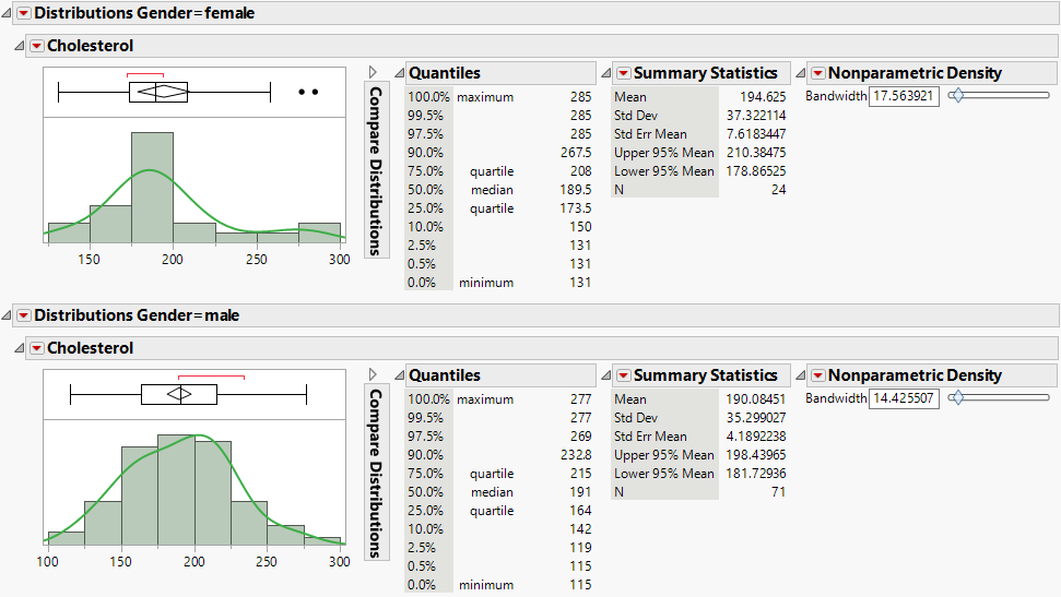

This example shows you how to use a By variable to create a separate analysis for each level of a categorical variable.

This results in a separate analysis for each level of Gender (female and male).

Figure 3.14 Separate Distributions by GenderĀ
