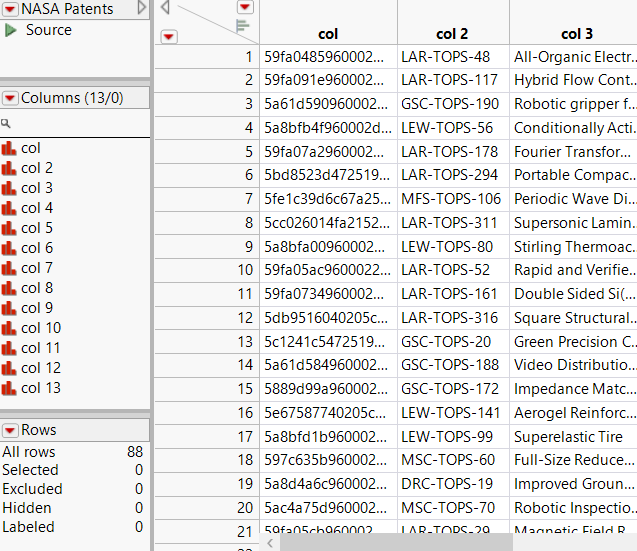

Return Data as a JMP Data Table
url = "http://technology.nasa.gov/api/query/patent/all";
request = New HTTP Request( URL( url ), Method( "Get" ) );
json = request << Send();
jsl_json = Parse JSON( json );
json = As JSON Expr( jsl_json["results"] );
dt = JSON To Data Table(
	json,
	JSON Settings(
		Stack( 0 ),
		Col(
			"/root",
			Column Name( "root" ),
			Fill( "Use Once" ),
			Type( "Pandas Values" ),
			Format( {"Best"} ),
			Modeling Type( "Continuous" )
dt << Set Name( "NASA Patents" );
Figure 14.5 Data Imported in a Data Table
