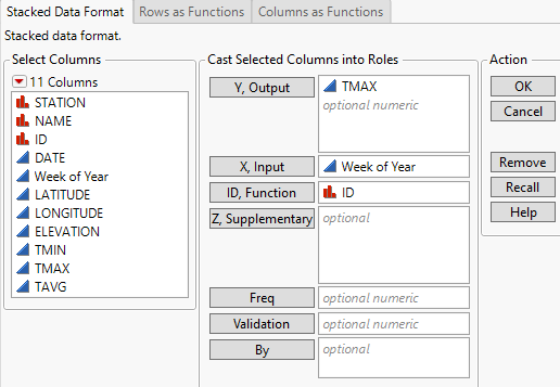

Figure 16.5 Functional Data Explorer Launch Window
The Functional Data Explorer launch window includes tabs for different types of data formats. Select the tab based on your data format.
