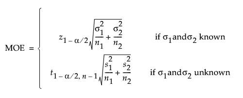

The margin of error (MOE) is calculated as follows:

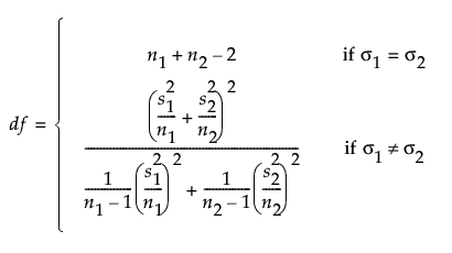

where
