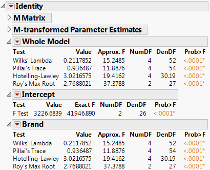

Example Choosing a Response
1. Complete step 1 through step 6 in Example of a Multiple Response Model.
2. Click the Choose Response button and select Identity.
3. Click Run.
Figure 9.8 Multivariate Test Reports
The M Matrix report gives the response design that you specified. The M-transformed Parameter Estimates report gives the original parameter estimates matrix multiplied by the transpose of the M matrix.
Note: Initially in this chapter, the matrix names E and H refer to the error and hypothesis cross products. After specification of a response design, E and H refer to those matrices transformed by the response design, which are actually M´EM and M´HM.
